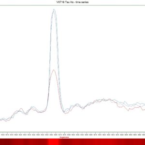

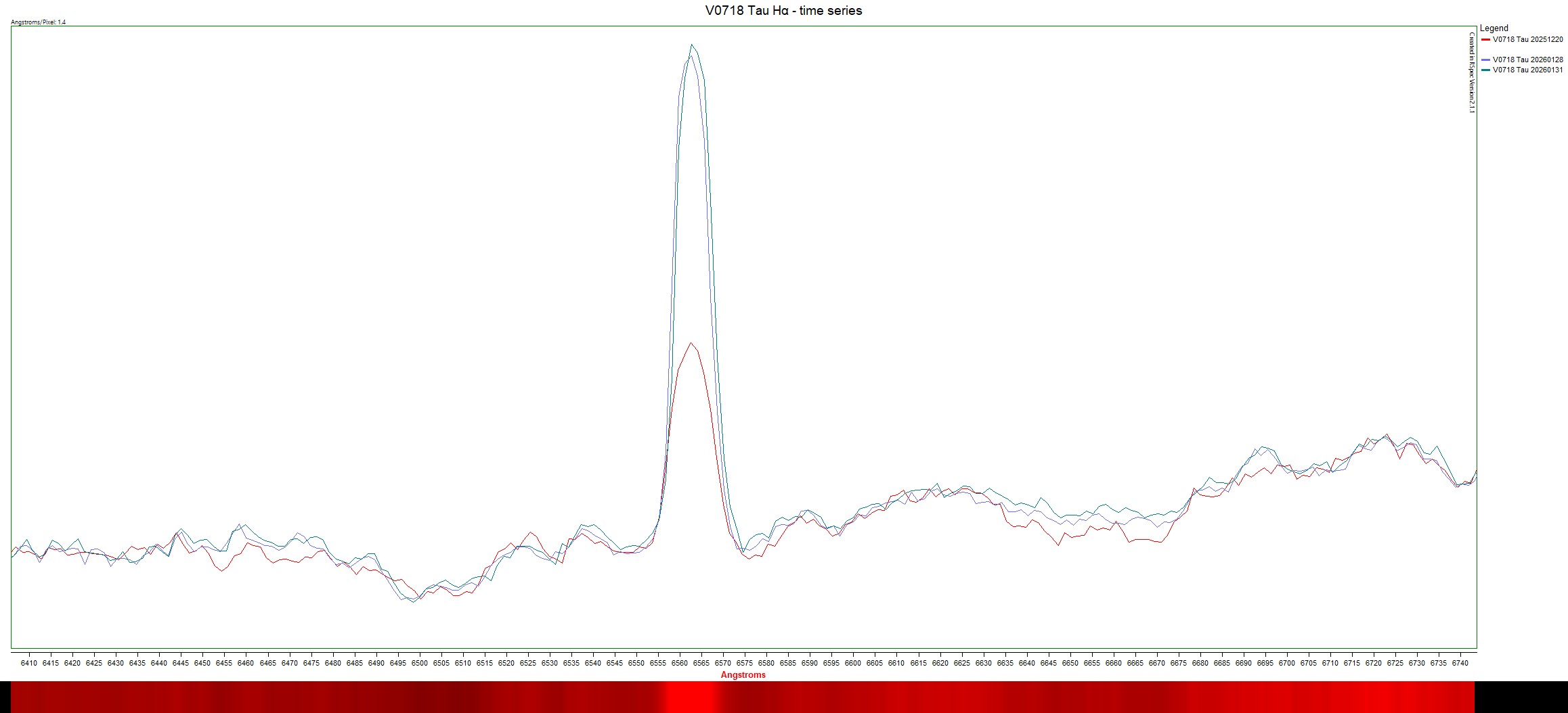

    Hej.
    Här kommer en inzoomad vy av H-alfa linjen i emission för stjärnan. På bara en dryg månad har intensiteten ökat ordentligt. Den spektrala upplösningen är för låg för att se strukturer i linjen. Vore intressant att veta vad som ligger bakom. Frågade Herr A.I. och fick några förslag:
    Key Mechanisms of Intensity Variation
    Rotation: As a star rotates, magnetic active regions move into and out of the observer's view, causing periodic changes in Hα intensity.
    Stellar Flares: Rapid, high-energy magnetic reconnection events can cause sudden, dramatic spikes in Hα emission intensity.
    Temperature & Mass Density: In the solar chromosphere, Hα intensity is particularly sensitive to mass density; higher formation heights generally correlate with lower intensity.
    Stellar Evolution (Age): Younger stars (typically <1.5 Gyr) generally exhibit much stronger and more variable Hα emission due to faster rotation and more vigorous magnetic dynamos.
    Circumstellar Material: In massive or young stars, variations are often caused by mass-loss events, dense stellar winds, or interactions with accretion disks (double star).
